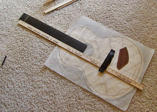

I've been trying to figure this out on my own but decided to just fess up and ask for help. I'm having trouble figuring out where to locate the bridgeplate on this guitar due to a new scalelength and bridgeplate design.
Here you can see what's going on. I've eyeballed (but carefully) where the saddle's going to be on this guitar. It puts the front of the bridge a hair past the front of the bridgeplate per my old layout. How much plate do I
want in front of the bridge?

James,
How about you work out where the bridgeplate would have been in relation to the saddle/bridge for the old scale length - say measure the front edge of the bridge to the front edge of the bridgeplate - keep the bridgeplate the same width and move it up into the X brace until the distance from the front of the new bridge position to front edge of the bridgeplate is the same. The shape to meet the X brace legs will need to be accordingly adjusted.
Hope this makes sense.

I usually have about the same amount of bridgeplate in front of the front edge of the bridge as I do behind, so if you are using the same width bridgeplate as before, just position it accordingly.
Let me guess - you don't remember the width of the old bridgeplate Dave White39031.7060300926

I do as Cumpiano recommends: the bridge patch extend 1/8 in front of the bridge and 1/4 below the back edge of the bridgeAlain Lambert39031.8851851852

Thanks guys. Alain, I took a second look in Cumpiano/Natel. and just
saw that as well. Their bracing chapter could've been organized better.

James, your "rule" casts some doubt on whether you should be modifying any plans. So does your question. One short answer is to put the patch where it will extend 1/8" beyond the front and rear edges of the bridge.   But guitar designs are not meant for piecemeal modifications. It's all connected. If you shorten the scale (as you apparently are doing), the location of the X and all the other braces changes. I start with bridge location and lay out the bracing based on that starting point.
Now, you may build a nice guitar taking those plans and just moving the bridge and plate, even though the bracing is designed for a different scale. But you will be getting a wrong conception of how the elements of a design tie together.
Maybe you should ask James Ashjian. He seems to be accurate to within 1/8", more or less. Howard Klepper39032.1488773148

despite the somewhat dismissive and sarcastic aspects of howard's post, technically he is essentially correct. the design does have to tie in.
and the various comments regarding the bridge plate's position relative to the bridge are valid.
thus, whilst you might get away with moving the bridge toward the sound hole as indicated in your photo since it appears the pin holes will be clear of the braces and so forth, i doubt that you will get the best result that your materials might otherwise give you.
i notice that the fb you show has already been slotted. is it cut to your proposed new scale length?
